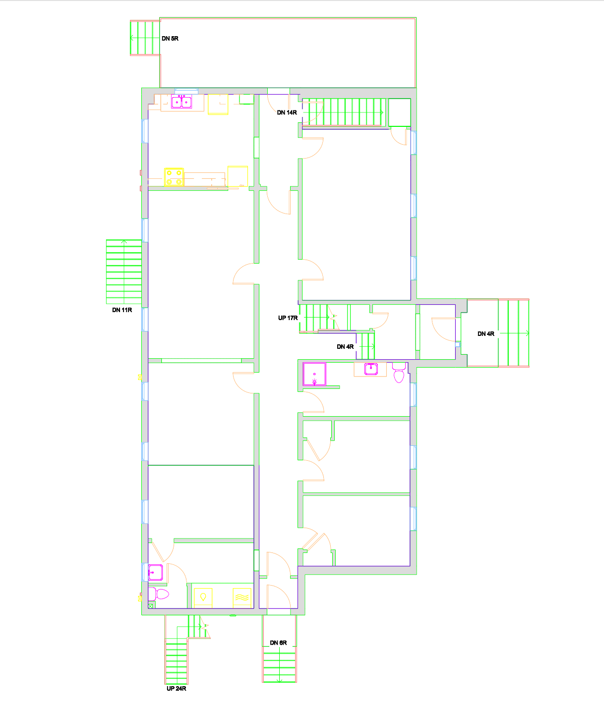

I just did that for a client, an iGuide Premium with a 2D floor plan. When I open the DWG in AutoDesk Viewer, I don’t see the text as described in your document. I assume that the C stands for ceiling height.
