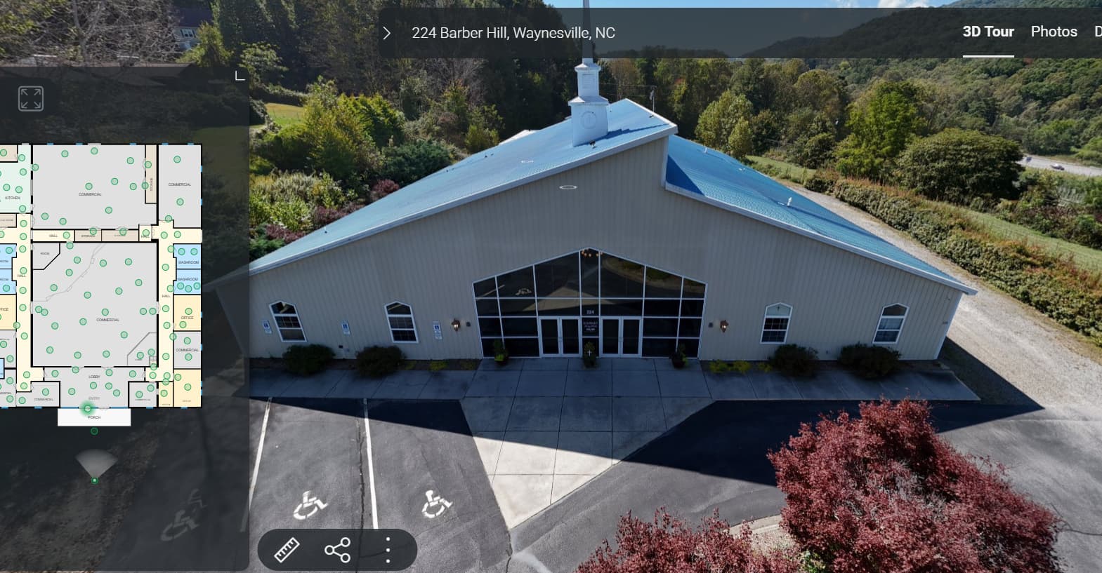

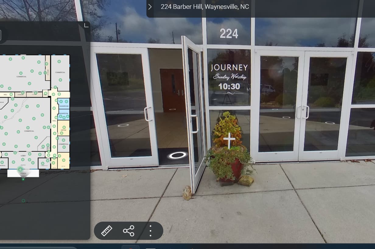

Do you see any of the ground points from the aerial? For example the front porch or yard? I’ve got my aerial showing on the main floor, but it doesn’t show any scan points. So if you don’t click on the floor plan you can’t get into the house.
I don’t see any “halos” at all from the aerial but if you click on the front of the building ( a huge church) it takes you to the first ground level pano which is at the front door.
